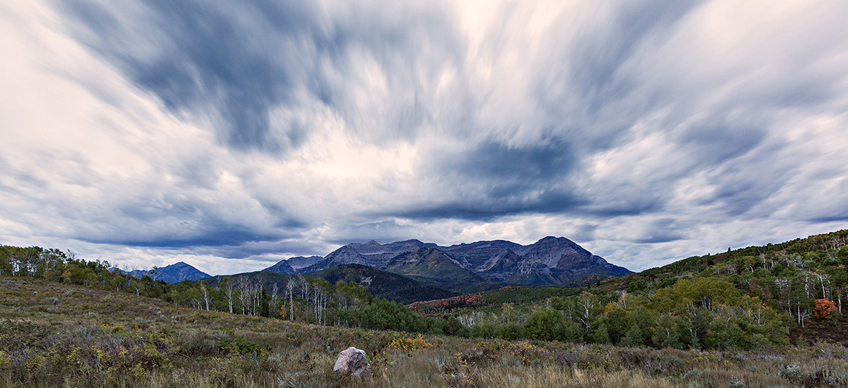

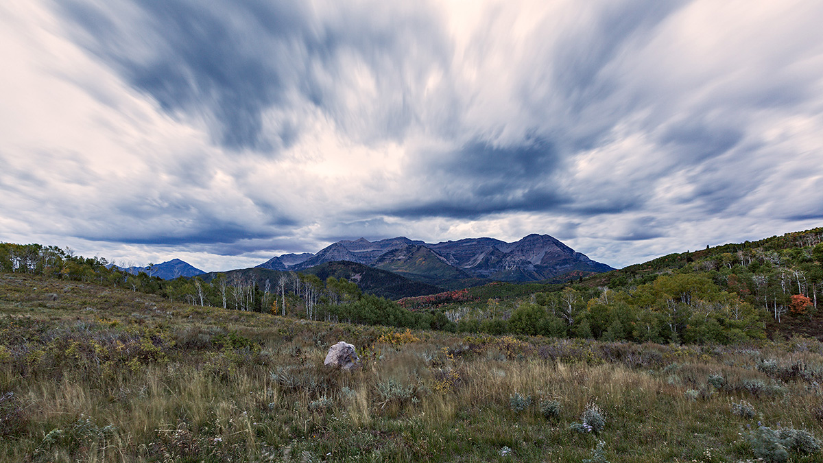

You only have so many choices about where to stand, which lens to use etc. In most cases when shooting primes, you may need to plan a crop. A properly leveled and positioned camera has a tendency to produce centered horizons. This can be fixed by cropping from top or bottom to get an off center horizon, sometime I tilt the camera, but usually not as it will cause vertical elements to lean.
Example of more centered full size image
Example of same image cropped from the bottom

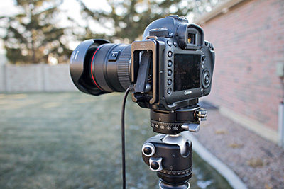

F11 is my standard aperture for landscapes. I have my focus training based on f11 and I get most of the possible depth of field, few dust bunnies and near maximum lens sharpness. ISO starts at 100 and shutter speed goes where required. Working from a tripod with MLU and cable release, I usually have the option to shoot at low shutter speeds unless it is windy. I always start with ISO100 but prefer not to have motion in my shots so I bump ISO to as much as 400 to preserve a shutter speed that freezes motion.

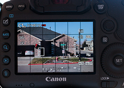

If your camera has a timer and auto bracketing in live view mode one press of the release gives a pause then the fires off a set of brackets.
