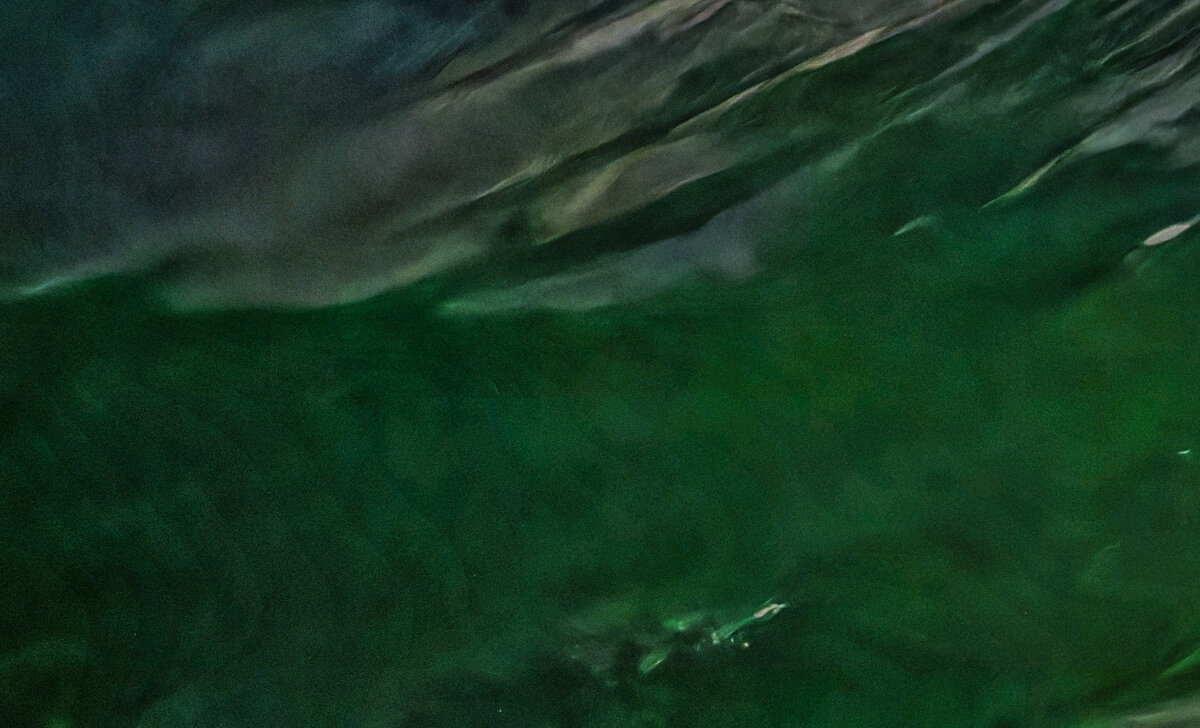

I had mentioned in another thread about terraced patterns being introduced by DXO PureRaw4, so I was able to back and find the images that I had noticed them in last year. This is from PhotoLabs 7, which Alan can correct me, was supposed to use PureRaw4 as the Engine for the top NR in it. I do have the stand alone PureRaw3 and the results were the same. I am including what I ended up using, Adobe ACR image uses the Enhanced Mode.
For a point of reference the image is about 3 stops underexposed for the ground.

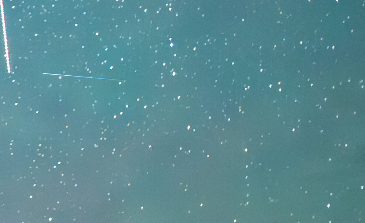

There was a 2nd issue I had forgotten about, the Terraced ground reminded me of the Philippines, so that's why that stuck in my mind. And I actually could have covered that up to an extent by darkening the ground more. The worst issue was actually the stars. DXO turned most of the fainter stars along the edges into what looks like Tadpoles. It adds tails to most of the stars.
When I was processing this, I had kind of covered up the terraces by taking the ground darker, and it wasn't until I was finishing up that I happened to zoom in on the stars and then see all of the stars being ruined by the made up tails. I had never had that issue before with Photoshop and ACR, so I didn't even know to check. That was a bunch of hours down the drain, because there was no correcting that. I had to go back and restart the whole process on this timelapse set of images in ACR then.
The NR was set in both to about 70%, I don't recall the exact amount. But I adjusted the slider until the Noise disappeared. The WB is a bit different between the 2, but similar. But that doesn't affect the Noise Reduction.

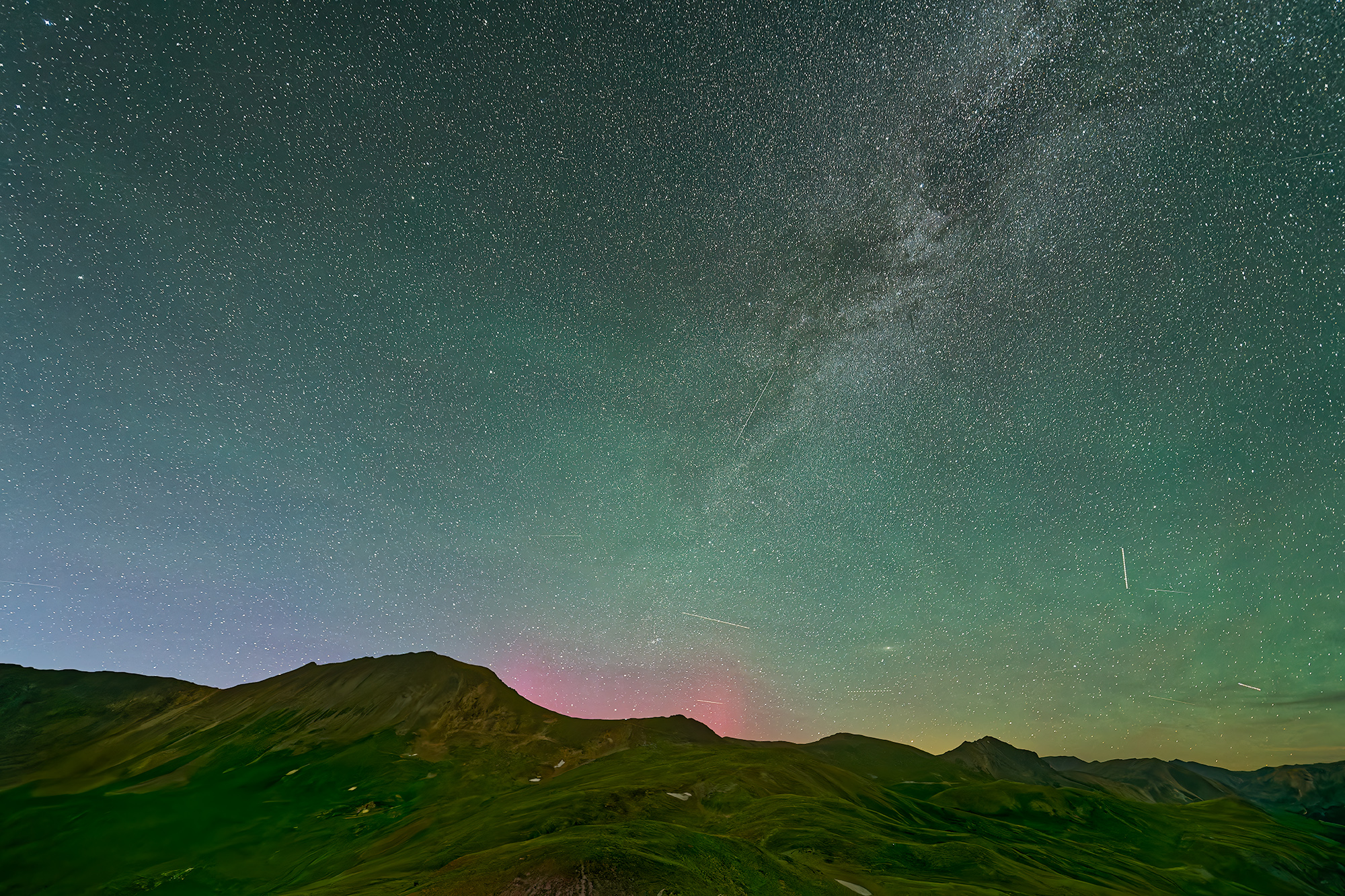

1. DXO PureRaw Full image

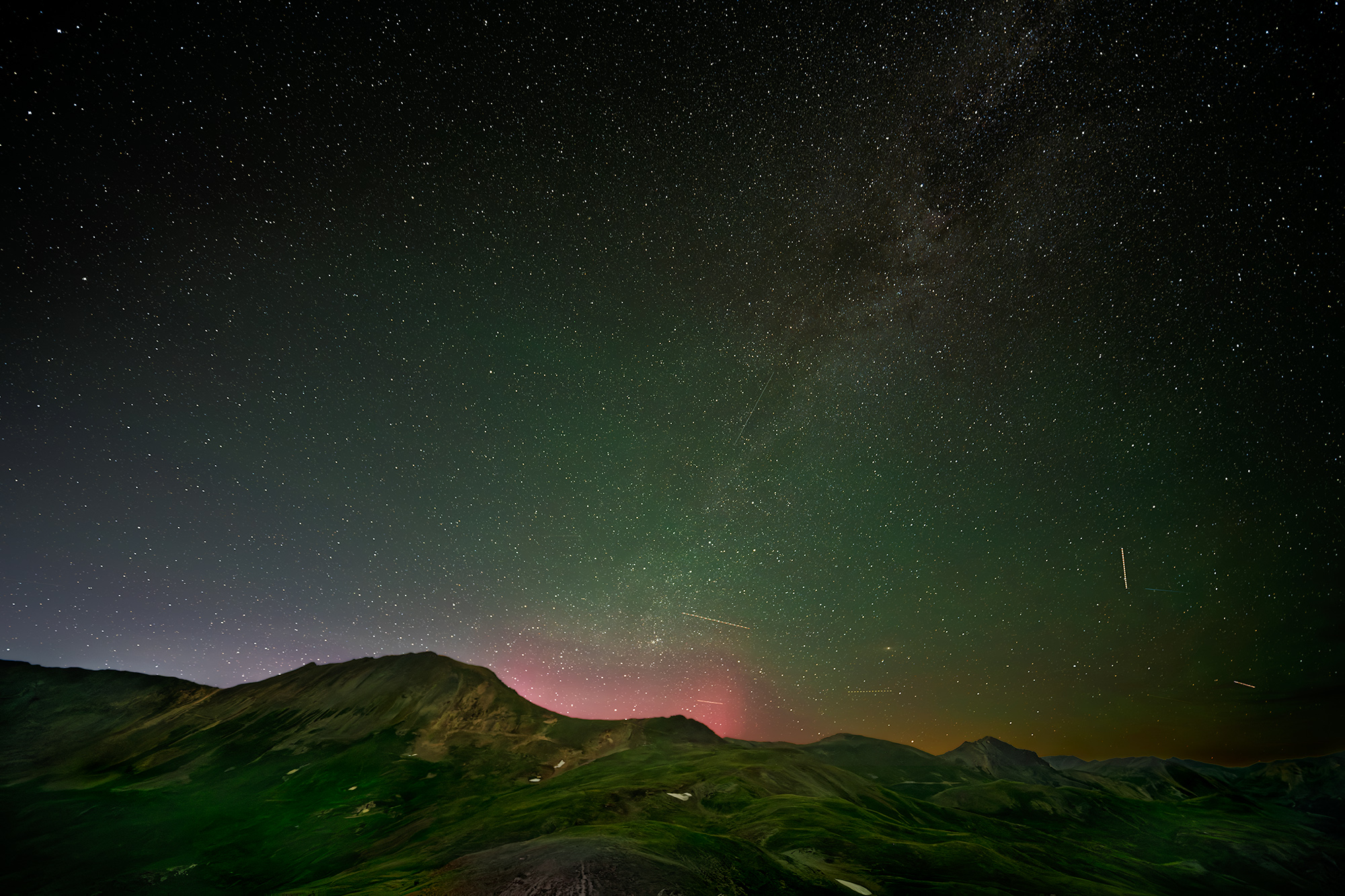

2. Adobe ACR Full image
3. DXO PureRaw Lower Left - Notice the terraced patterns, and then there is even a straight line like it's a section.

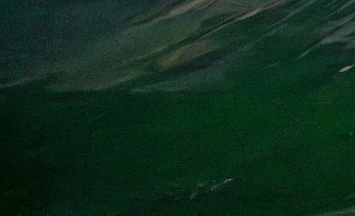

4. Adobe ACR Lower Left
5. DXO PureRaw Lower Right Side Sky - Notice all of the tails coming off so many of the stars. In other areas it seemed to have even added stars and texture that wasn't there.

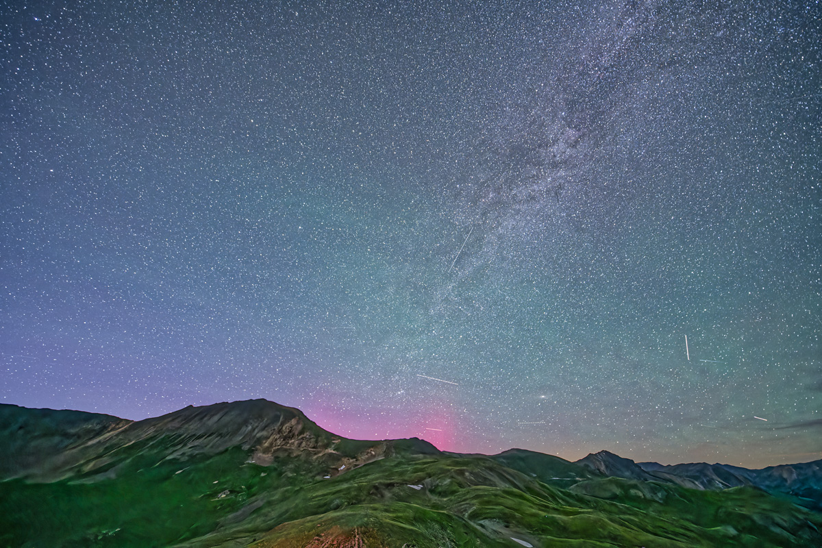

6. Adobe ACR Lower Right Side Sky

I'll say that I don't like the ground in either of them. I'd rather have some noise than the smeared look that is there.
I've seen the same sky behavior from pureRaw.

Agree with Kyle. Underexposed 3 stops is pushing the limit. Its either going to get smeared or the AI will try to create something there so it is not smeared. I rarely push shadows even 2 stops.

I agree both of these are too plasticky. If that's a word...
I personally would rather work (which I did) with a ground layer that has less details then one that has made up details, especially that terraced pattern. If I put out a photo of the mountains with what looks like rice terraces, people are going to say fake.
So I could work with ACR and make it so it didn't look as smeared by recovering the ground in steps. But the terrace pattern was there in the DXO version no matter what I did.

I agree, neither are favorable, but in the end, made up terrace patterns can't be covered up. At least ACR didn't invent shapes into an area. So for my working versions, I did ACR in smaller steps to not have the ground be plastic.
In the original, without any editing, the ground is just black. The ACR version is the most true to what the canera captured. If I just raised the exposure and ignored the noise, it looked like the ACR version as far as textures go. I can post a SOOC jpg, but it's just black to the eye on the ground.
What about how DXO ruined the stars?
My efforts to raise the dead were not exactly fruitful as the lower left corner didn't have much in the way of useful data to recover. This my take on his MW shot after running it through PureRAW4 and doing a lot of touchup work in LR and PS:

For this particular image keeping the ground layer dark with just a hint of detail will probably work best.
Fully agree - I tried to match what Jim was doing with his image at the top but it does feel like too much light. I like the first of the edits I tried better than the version using Photolab 8. That one just feels like too way much light unless you had a full moon.
One more using PhotoLab 8 with a pass through Topa DeNoiseAI in Photoshop:
Need the 100% crop of the lower left and the stars to compare to mine. I don't think anything would show up at this.
I do like the overall look of what you got in this though, but it's the 100% detail I would want to see so I could tell if when someone is playing the compiled timelapse on their 70" TV, that there are no rice terraces showing up in the ground layer. :)
And Alan, it doesn't have to have detail, it just has to not have made up detail. Adobe ACR did this without adding made up detail, And I could do it less aggressively so it doesn't look Plastic. That was just a fast run through on my part to show the ACR isn't making up detail.
And that's what I did in my finished processing, I kept it darker which helped hide some of the noise as well. My whole point is that PureRaw was inventing and adding detail that didn't exist, while Adobe ACR doesn't. And I easily could have not pushed ACR to the point where it was looking plastic. My use case is probably extreme compared to most people, but it exists. And a huge portion of my photography is at night. I can't use a program that adds non existant detail to images or adds stars and details to the sky when I try to present an honest view of the night sky.
