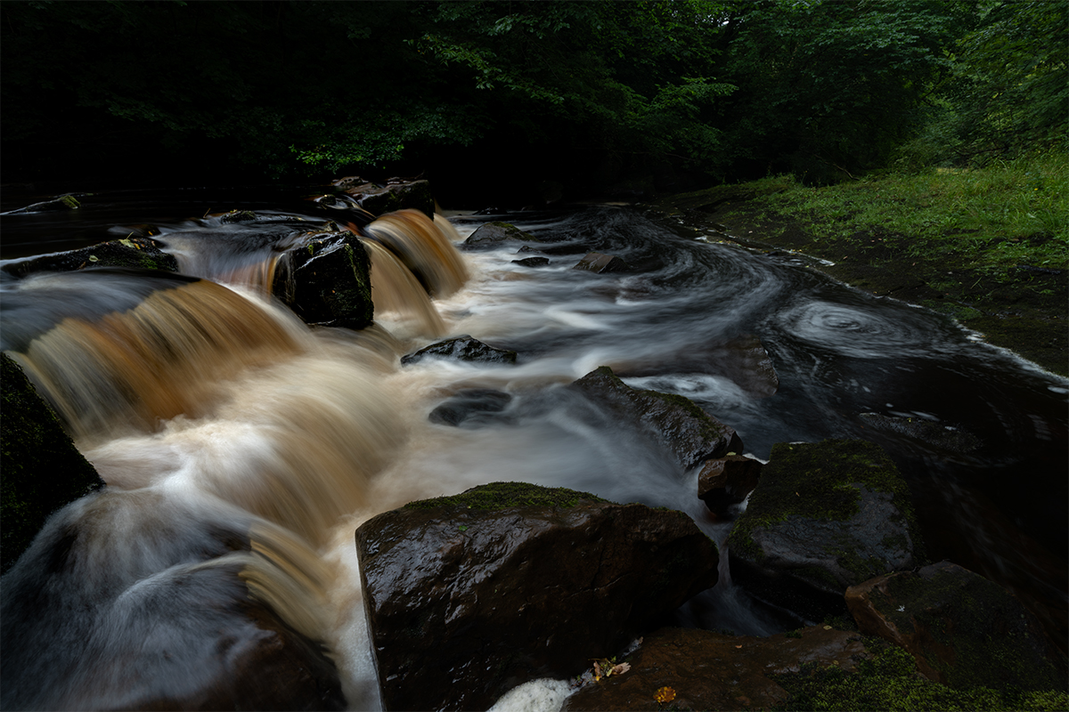

Here are the 5 images stacked and the average calculated
As you can see it looks like a long'ish exposure but the small falls look soft because 1.5s is too long to show much detail.
Now the clever bit
I merge and mask one of the 0.3 s images into the above stack

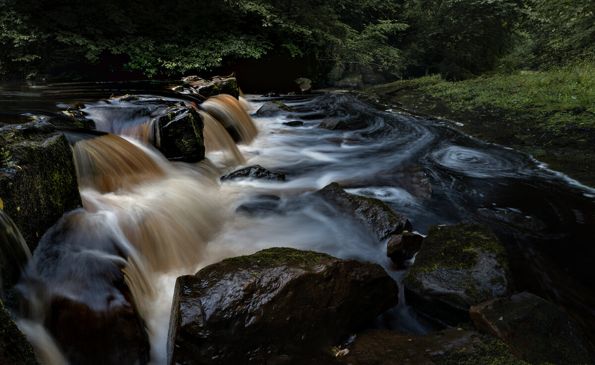

I was using a 16mm lens but I wanted a slightly wider image so I produced a pano using the 5 shot technique and here is the final image.
If you haven't seen this technique a quick google found this.
https://www.wardynskiphoto.com/gallery/how-to-simulate-long-exposures-in-photoshop/
Looking at this image the swirls and trails are a little "choppy" so 10 image at 0.15s should even this out. I will make sure that I have plenty of cloths on my next outing and will compare the 2 methods but and an important but I know that if I want to buy a 12 or 14mm ultra-wide and can't use filters then this technique will enable me to produce long exposures and I do like them a lot. Ken
