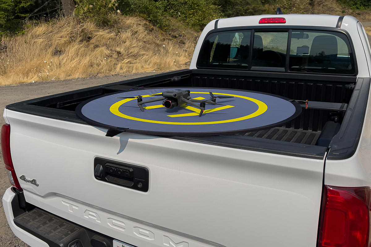

After doing a bit of flying in the Gorge a couple of weeks ago I decided I needed a solution for launch/landing that would keep my drone's prop wash away from the dirt. Our typically bone dry summers and the volcanic soils in the Cascades are a bad combination for fine dust and my Mavic 3 can kick a lot of it up. I have played a little with various landing pad solutions but decided to try something that would let me use the back of my truck. I have landed my drone in the truck bed itself but the avoidance sensors don't particularly like dropping down into the bed all that much and with windy conditions it would be all too easy to get bumped into the sides of the bed.
I ended up building a small bracket that fits just on top of a rail in the bed of the truck at the same height as the top of the truck bed. This lets me drop a folding landing pad down on top of the tail gate and the bracket surface and fasten it down with small bungee cords:
I thread another bungee cord off the loop tab you can see just above the gate latch and then hang a small bag of load straps from it to weight down the back. Turns out I really needed that rear weight today as it was rather breezy. The grass just to the left of the road gives an indication of the wind.

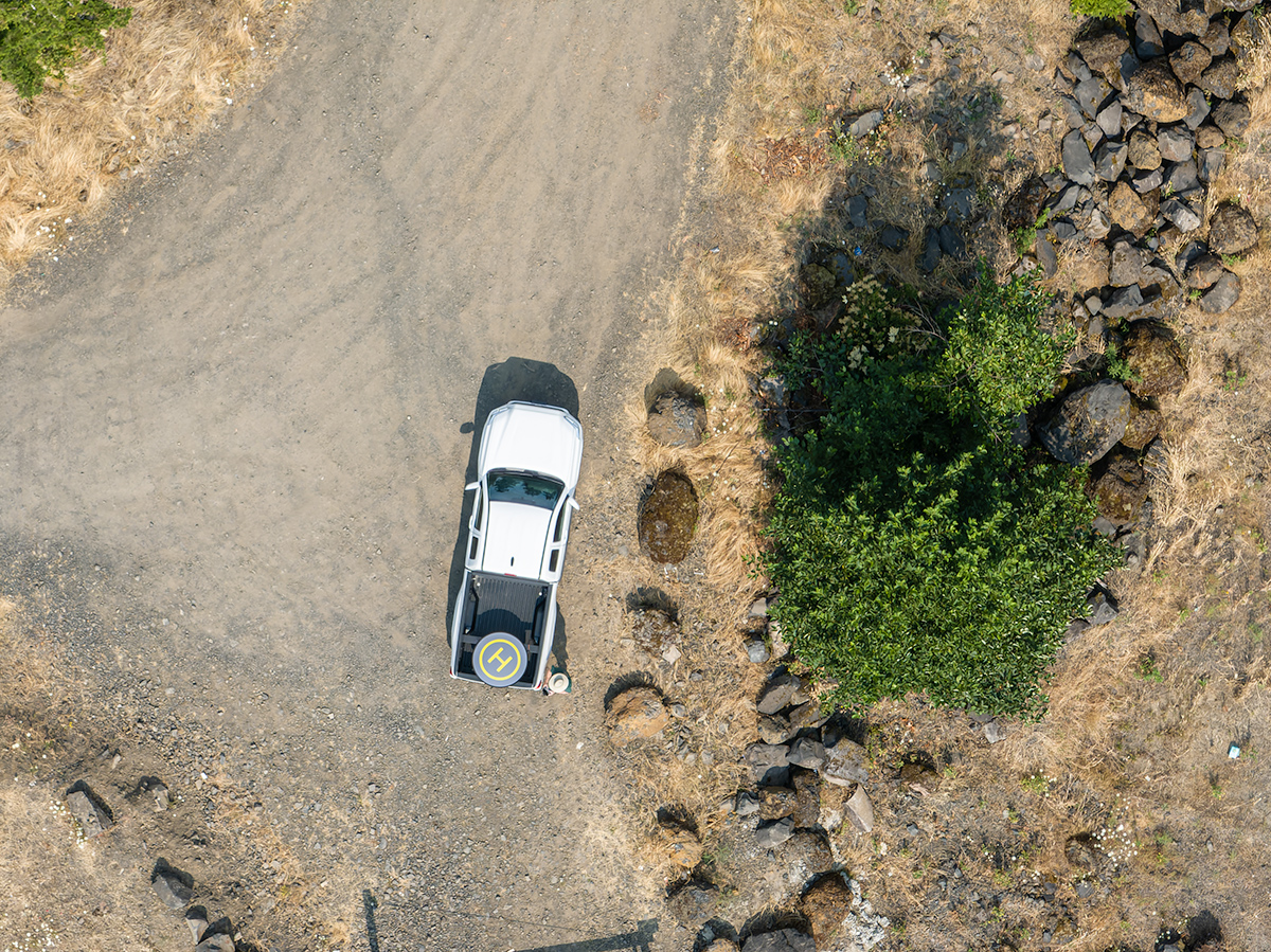

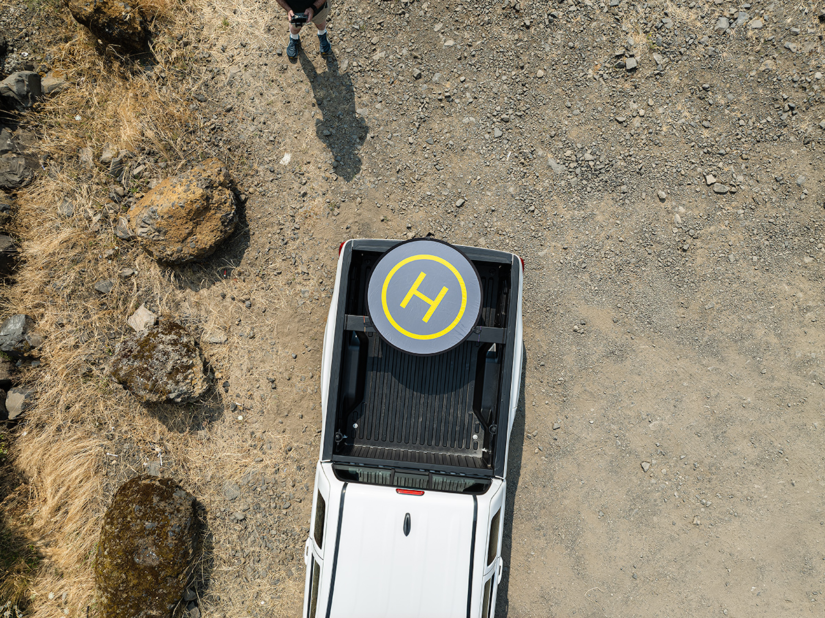

Here is what it looks like from the air - one taken right after launch at low altitude and a second image from about 300'.

The Mavic 3 RTH is not more accurate. I have never really allowed mine to hit the ground after RTH has been invoked and the best approximation I have seen so far was about 3' off which would not work with my truck landing pad. This is a 45" landing pad as as you can see in the first image you have around 16" margin of error at best.
I did play with this today and tried using RTH once. I made certain that the controller had set the Home point while still hovering directly over the launch point and had turned the gimbal straight down to confirm this (image #2 above). After flying around and getting some shots of Table Mountain and more of the Bridge of the Gods slide area I turned the gimbal down to 90º and hit the RTH button. It got back to vaguely overhead but as the drone was descending I could easily see that it would have missed my truck entirely so I aborted RTH and landed manually.

Nice Alan. I figure it is made of plywood?

Thanks Jeffrey - yes it's 12mm baltic birch ply. I have hand caught mine quite a few times but as you mentioned be careful. The longer arms for the motors and the larger props puts the spinning blades a lot closer to your face than my Air 2 did. The Phantom 4 has even more pull yet? On one occasion when I was trying a hand catch the drone decided it wasn't going to play along and it revved up the motors and yanked itself out of my hand. I can't imagine trying to remove the battery while the drone is trying to fly away!
