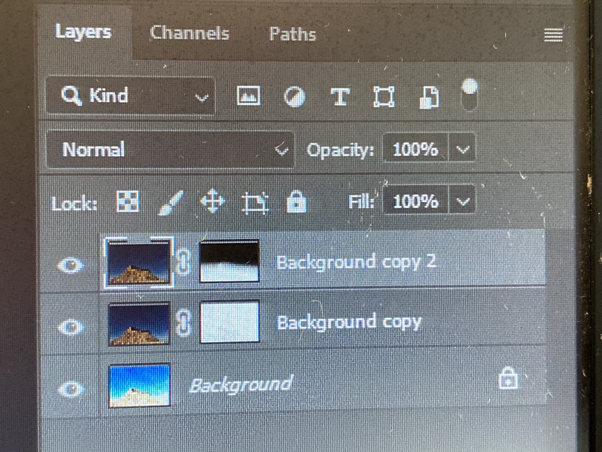

First off, you aren't selecting blue stars. This method won't select every single star in the sky. It's using the Color Range tool, which means it selects based on color. So you are selecting "whitish" colored stars. If you want to select blue/cyan colored stars you would do it a second time, but because the sky is blue/cyan it will take some careful layer masking. But I almost always just use the white stars.
2nd, you are making the first large selection for the area in the sky the stars are in, then you are making that into the top layer mask.
(The selection disappears since you made it into a Layer Mask)
3rd, then on the middle layer you are making a selection of just the stars with the Color Range tool, and turning that into a layer mask.
4th, the bottom layer you brighten to make the stars shine more.
One second, I will add a screen shot from my iPhone.

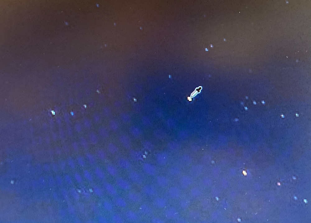

Just using your jpg, since it was such low resolution I had to go to 200% for the stars to be big enough, but I could see and click on the stars.
Again, one sec, let me upload another from my iPhone.
At 200% this is what I see towards the middle right. The stars are plenty bright enough to see. If you go back to your higher resolution version you were editing the stars would be plenty easy to select at just 100%.
