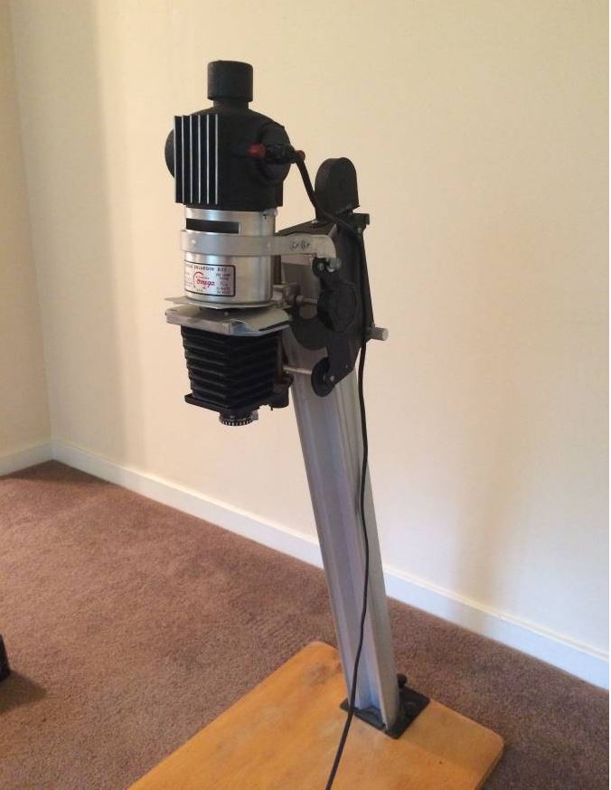

What follows is the basics of setting up a a film copy stand.
Many that I have seen incorporate a film enlarger column, like this one on Craigsiist for $60
Here's a picture of a enlarger like the column I procured.
You may have to make up a bracket to attach the camera.
I was lucky in that the adjustment section had a well placed hole that I used
