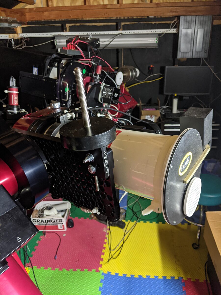

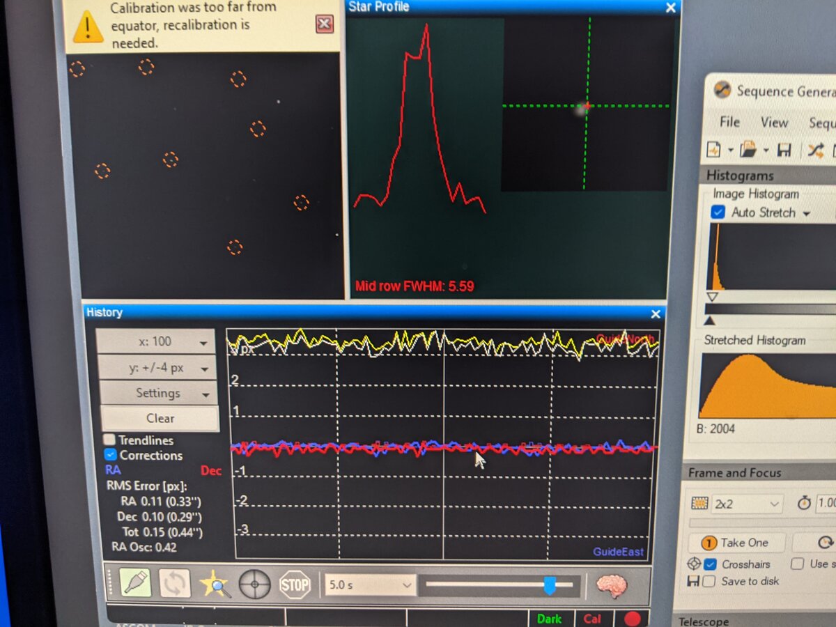

I had been having guiding issues for a long time back and forth with thinking it was issues with software I changed to phd 2 and could see it was trying it's best to push the guide star in the correct direction
So I thought to myself this has to be mechanical my mount was balanced in Ra and Dec but had never thought about the 3rd axis Z axis after watching utube I made the fix and guiding is perfect
