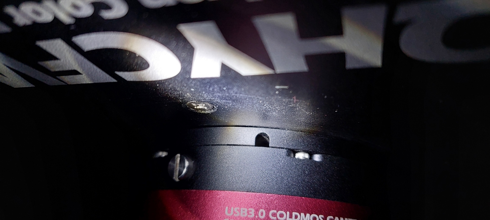

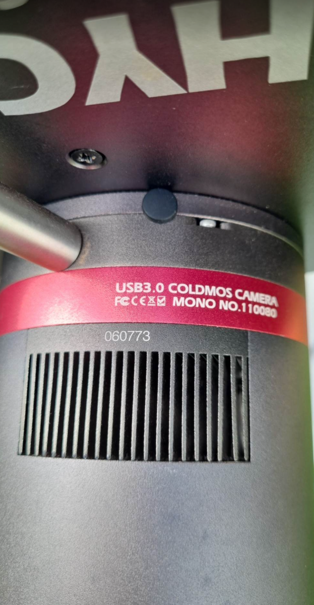

So here is the question for any of our users out there with the QHY268M (@CRTAstro? anyone else?) - what exactly is this hole on the side of the camera for? (I cannot examine it myself as the camera is obviously back down in AZ...)

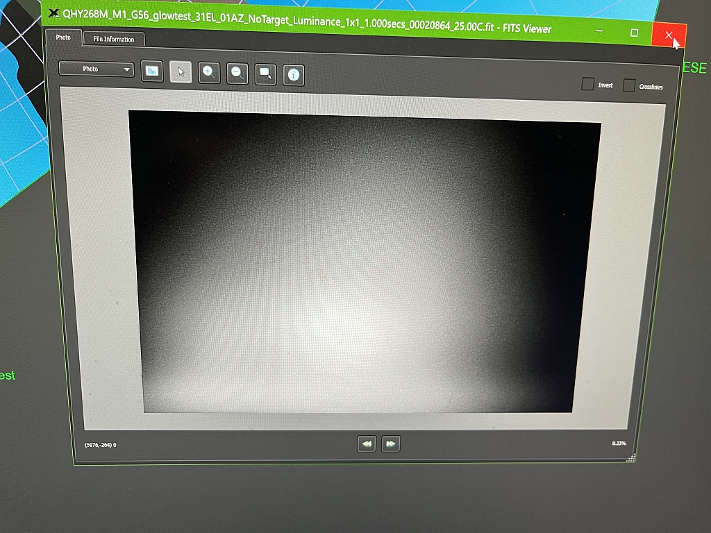

Because on my setup, with that hole uncovered in daylight (with the OTA objective cap firmly in place) I capture this in a 1 second image:
And with that hole covered with black tape under the same conditions I capture this...
What the @#@%$#@!!? I cannot believe this is supposed to work this way. Is this the desiccant tube port? I thought that was covered by a rubber cap if not used? I certainly never installed anything there. Is my camera somehow defective? camera is bolted directly to the filter wheel per the assembly instructions. I appear to be able to solve the problem with tape (at least for now) but I am quite certain everyone is not needing to resort to this hack. I HATE mysteries like this, and this one has cost me quite a lot of time and effort already. I have upwards of 40 hours of data collected on 2 targets that is corrupted by this (see previous posts...)

A reply I got from CN says that hole is to allow for the capability to blow air across the sensor cover glass, I guess either to clean it or to keep it from having dew issues? Not sure why that only exists on the mono camera. There is supposed to be a rubber plug that goes in there, I guess I either did not get one at all or it is in some accessory bag and I did not know I was supposed to install it. I think it is an oversight that they do not mention it prominently in their documentation, especially if it is not installed coming from the factory...

Sorry Mike...late to the game. That is pretty shocking if it's the source of a light leak. I am not familiar with QHY cams so specific forums/manufacturer would be the way to go. Plugging/taping it up seems to be the interim solution but still...
PS From a QHY268M astro friend of mine...he says his has a plug in it...will wait for a pic

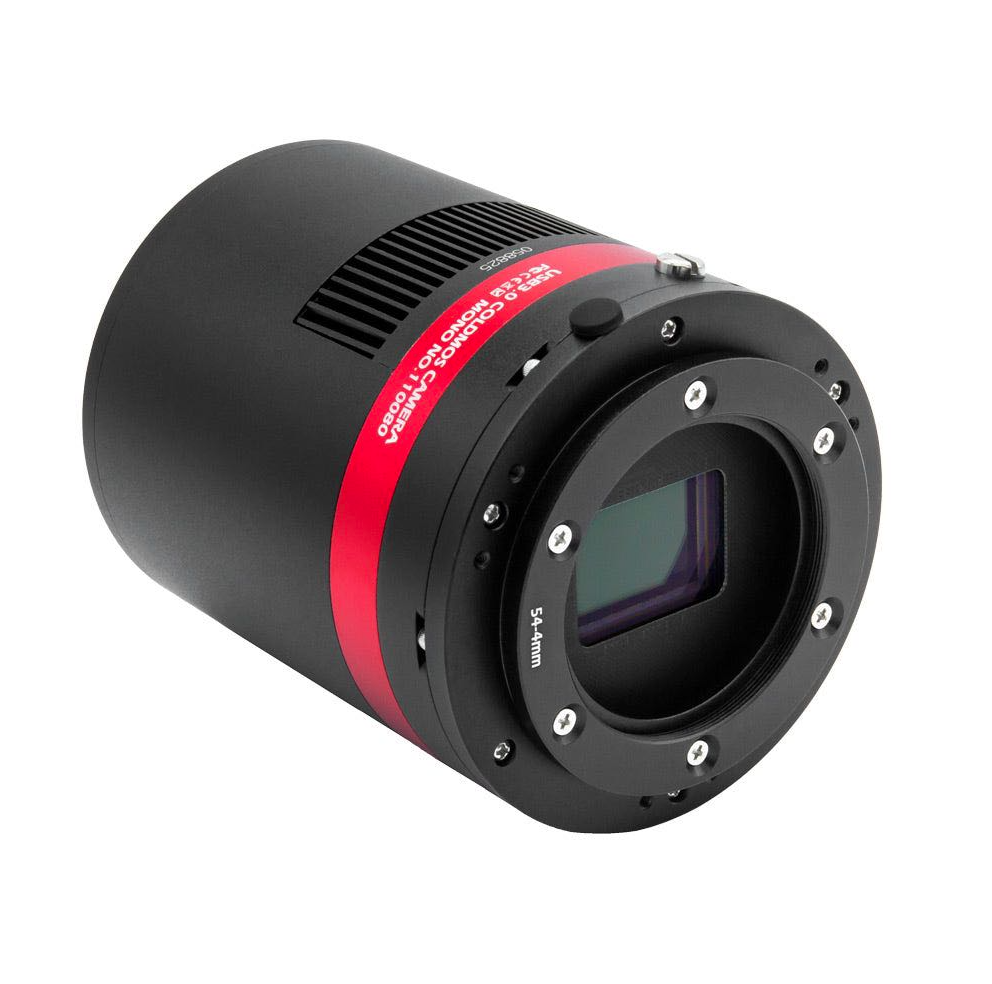

So here's the pic....looks like there should be a plug there
and more in this link
QHY268M - PHOTOGRAPHIC COOLED [MONOCHROME] | Testar Australia
With the desiccant tube attached:

@CRTAstro - Carlos, sorry, I failed to recall the nuance that you had the version of this camera from the 'other guys' :) I have a local friend here who just bought the QHY version of the camera and I talked to him. Amazingly, he had seen this plug fall out loose when he unpacked his camera, did not know where it was supposed to go, and so had laid it aside. He was no doubt going to have gone down the same rabbit hole I have been living in with this, until I explained what was up. he was able to reinstall it (and I think he taped over it too to keep it snugly in place...) For me, I had my friend do a tape only fix with 2 layers of tape:
It tests out as totally light tight now and I am FINALLY back in business. I sent a support email to QHY about getting another one, since I never saw one at all anywhere in my packaging, but so far no response. Chinese New Year perhaps? In any case I think I am fully operational now. Thanks for the help and chiming in, much appreciated.
