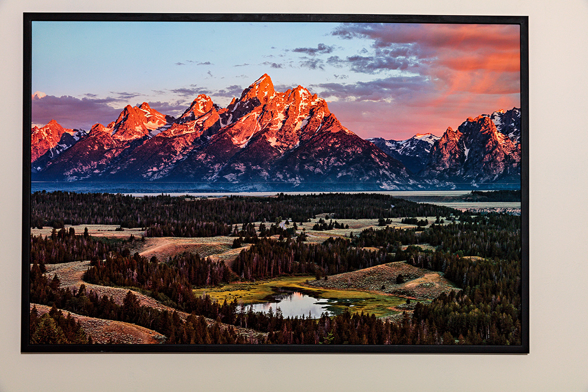

The spliced 30x45 with a printed border.

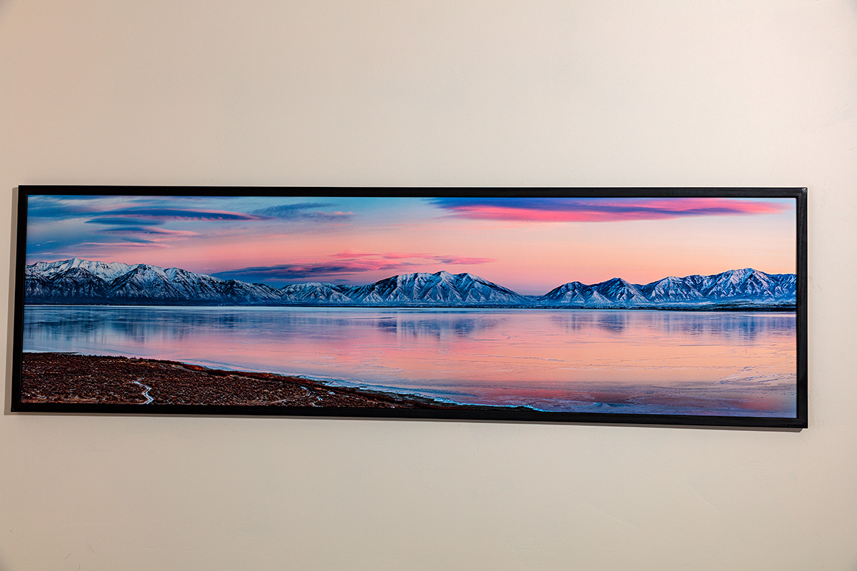

A 16x45 with a frame

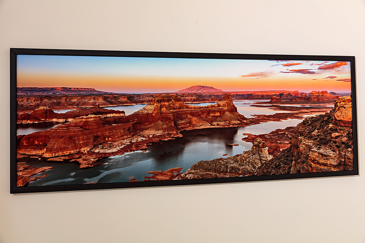

A 16x60 with a frame

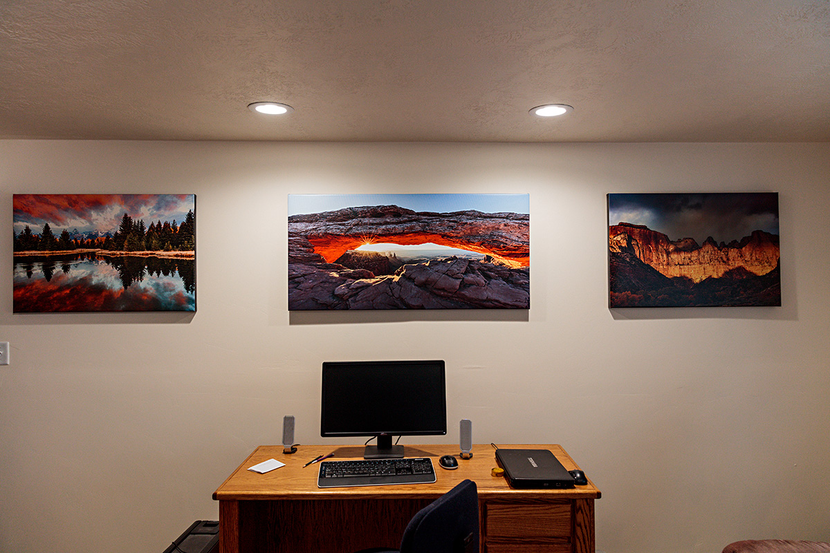

The canvas wraps

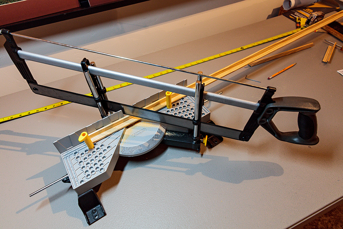

Ok, my Stanley miter saw came yesterday and I started a new 30x45 frame and wanted to show what it looks like during assembly.
The miter saw. It cuts very accurately and clean. Very little sanding required. Logan makes a 45 degree precision sander that I might get someday.

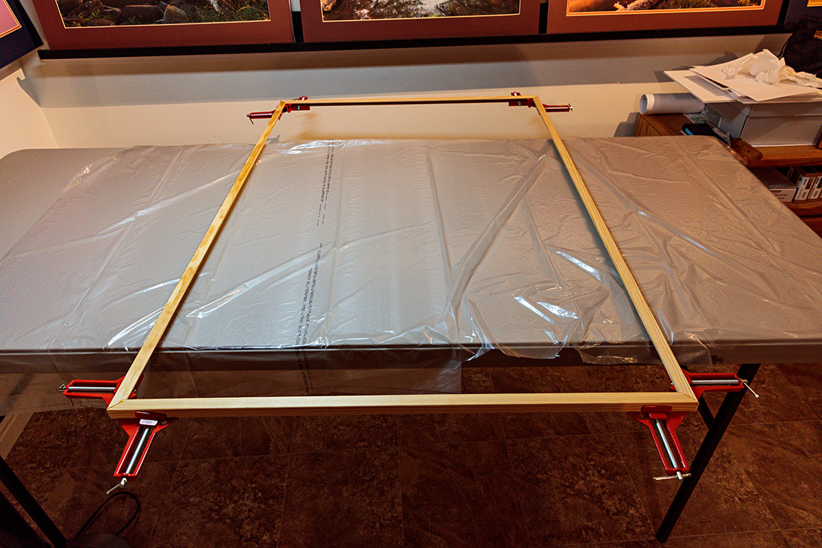

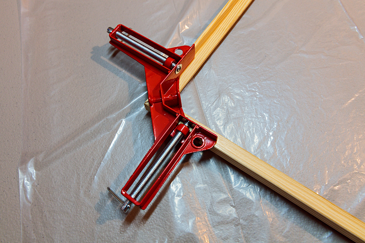

The clamp
The full frame clamped up. I glue two corners and let them cure overnight then do the other two.

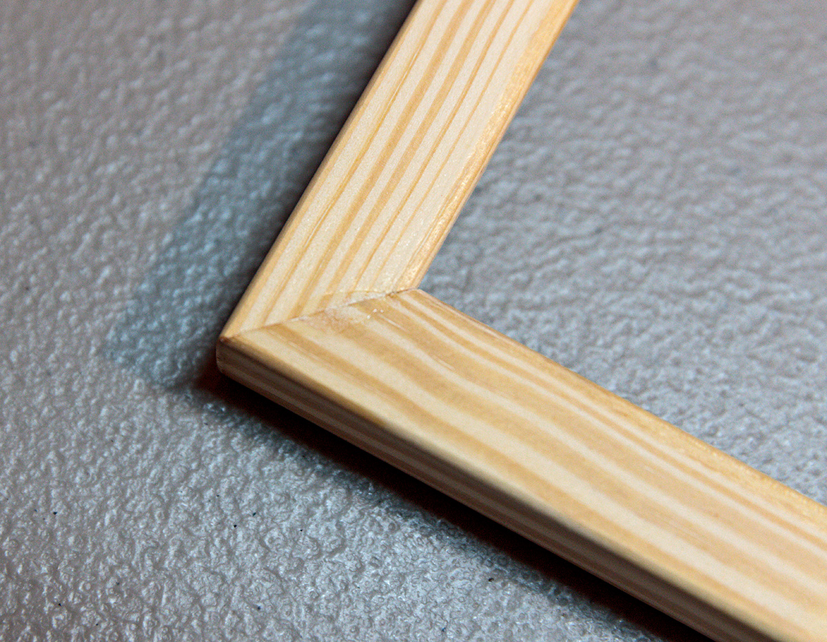

Ok, here is the frame during construction and finished.

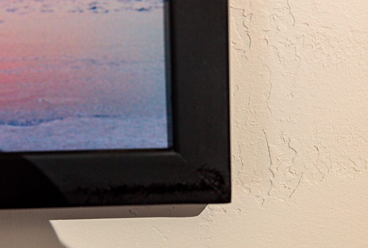

This is a corner, some not as good, and one broke and needed regluing. This wood is not large enough to provide adequate surface area for glue joints or staples in the corners. I will go to a heavier piece next time around.

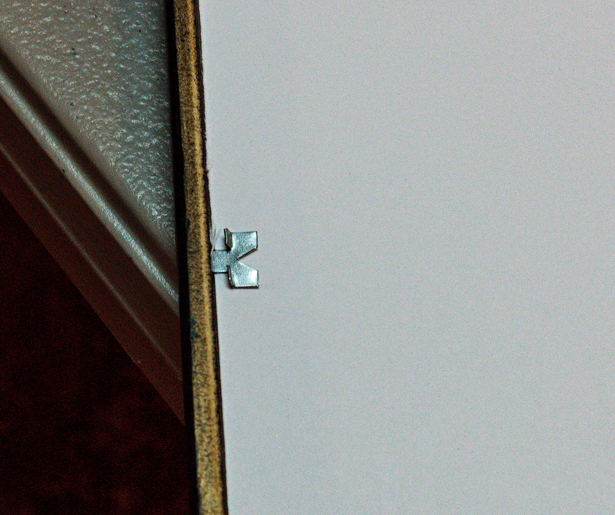

After finished and painted, I use these push points installed with pliers to hold the print in the frame.

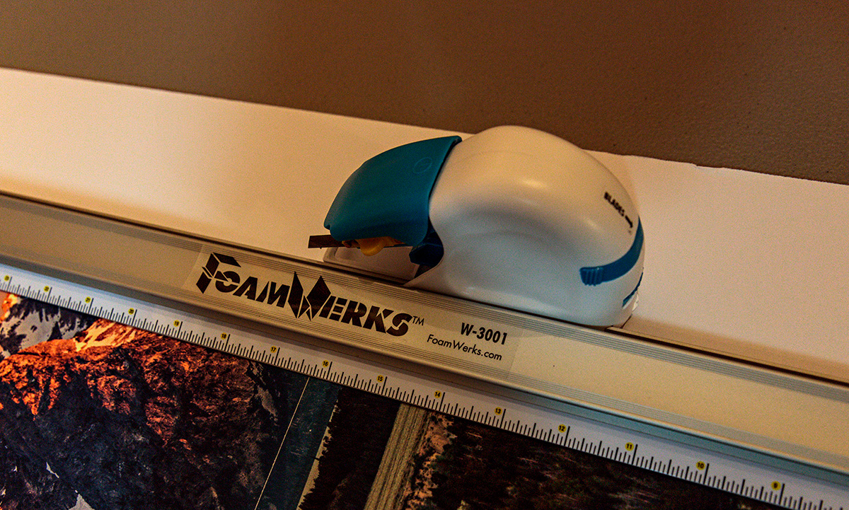

The print needed to be trimmed down to 30x45, recall it had printed borders, but I wanted as standard size in case I buy a picture this size. This is FoamWerks, by Logan. It has a guide rail and a depth setting. I just put a piece of scrap foamcore under the cutting area. It makes a clan cut all the way through.

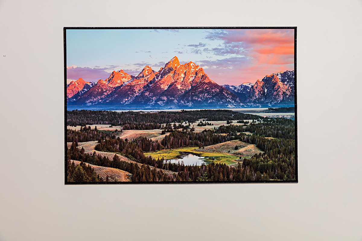

Here is the finished print hanging on the wall. It looks better now with this frame.
Nice result. I like your foam core cutter - basically the same as my track saw but with a razor knife.

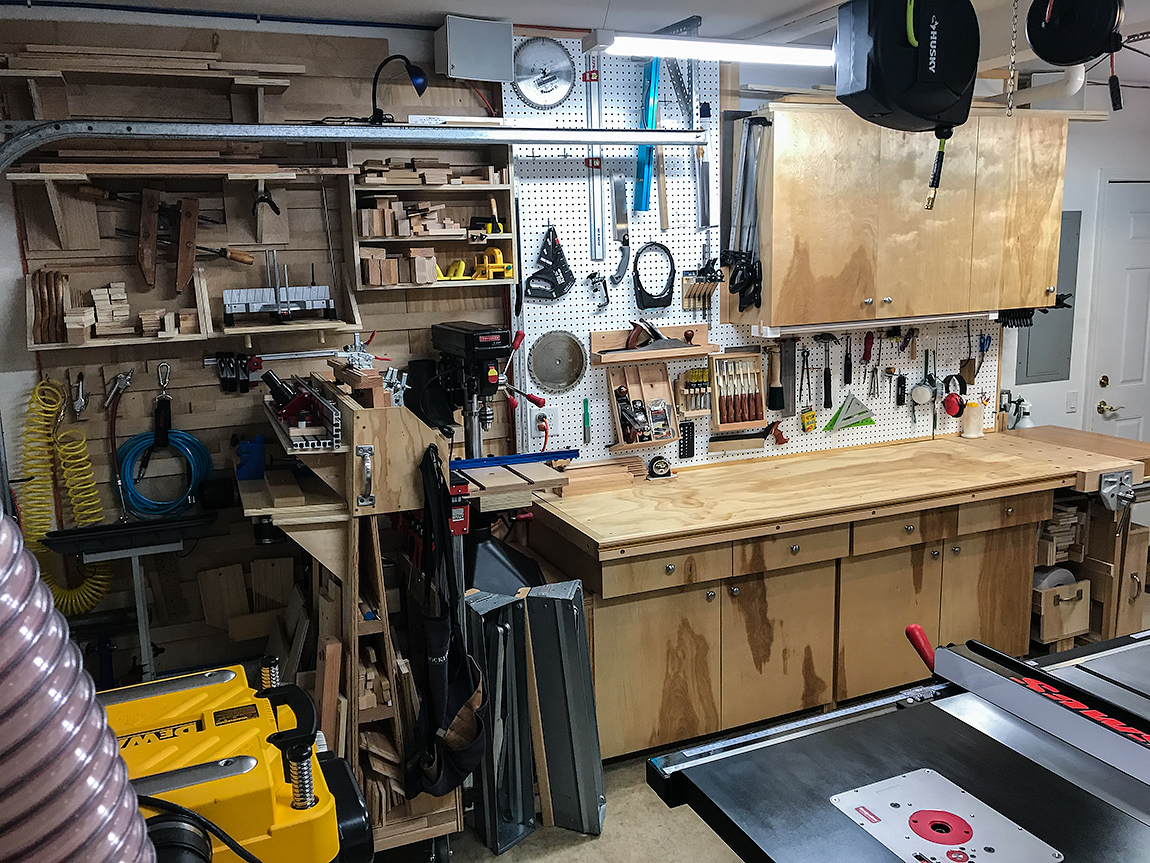

Are you buying the wood frame pieces or milling them? They wouldn't be hard to make at all with a router table and a table saw. For me that part would be a piece of cake and I can mill it out of any kind of wood I want.
What I do when I am not shooting pictures:
Nowhere near this clean at the moment with a new coastal maple coffee table top in the middle of this workbench (I have 2).
Man that's nice, I wish I had a place for a shop, but I live in a 55+ community with a small garage.

My shop is set up for making cabinets and furniture as a retirement hobby and moldings like the ones you are using wouldn't be hard for me to mill at all. Its tempting to play with some interesting hardwoods for a frame but that might detract from the image being displayed.
