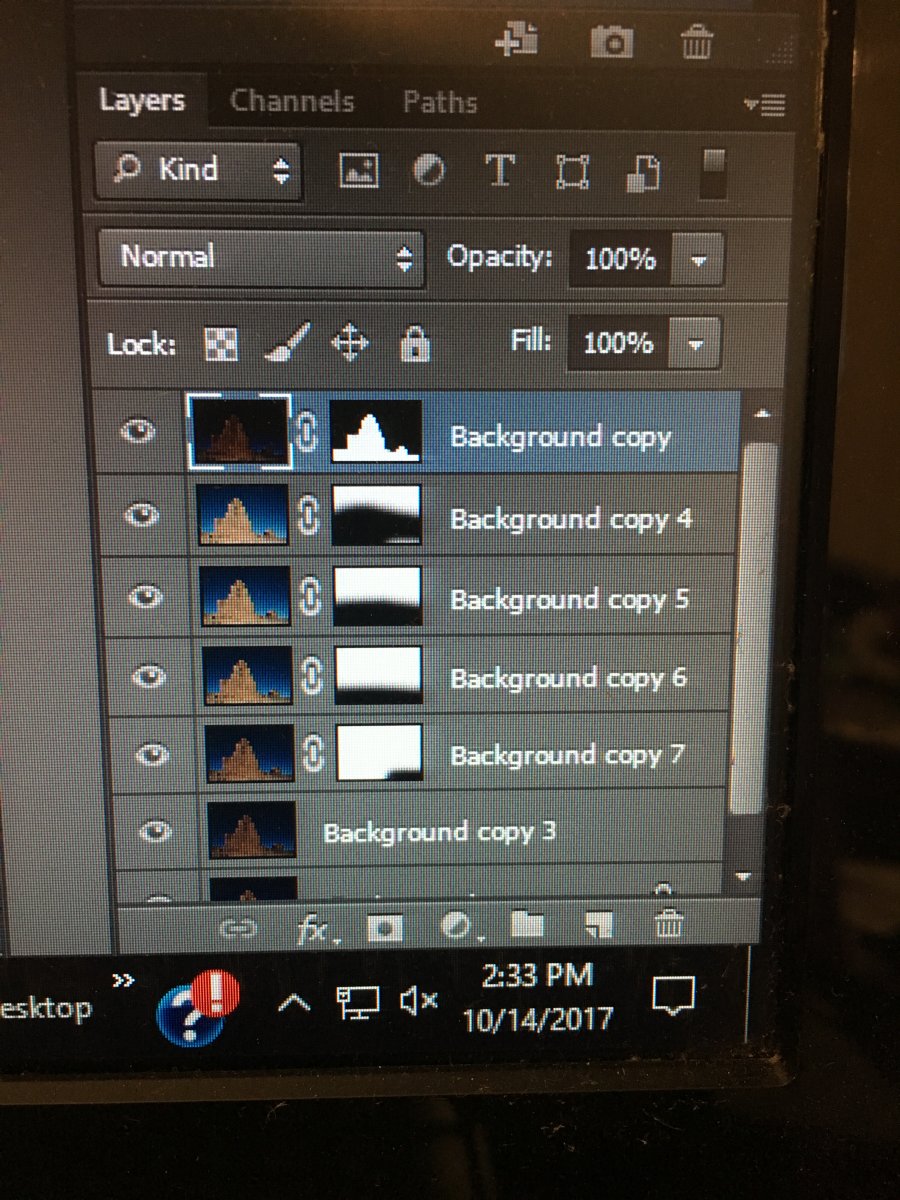

here is my attempt at your process. I noticed I had a dark band in the sky about 1/3 of the way up so it was hard to get it even. I also had a hard time getting it as bright as yours.
Hey Ben,
I realized I had missed a step in regards to the brightness of the sky. In the very beginning, after I selected the sky separately, on the layer below it, I brighten the midtones of the sky so that the upper parts were the brightness I wanted. Then in each of those successive layers I darkened the sky about 12% (midtones) at a time using the Level adjustment.
Hey Ben,
The only time I use Exposure is in ACR, I personally never use it in Photoshop itself. I just use the Levels adjustment. I have found the exposure adjustment like with the Dodge and Burn adjustments cause artifact issues.
Ok, another try, I think that other than a few masking errors, this is much closer to your edit.
Using levels as you did was the answer.
