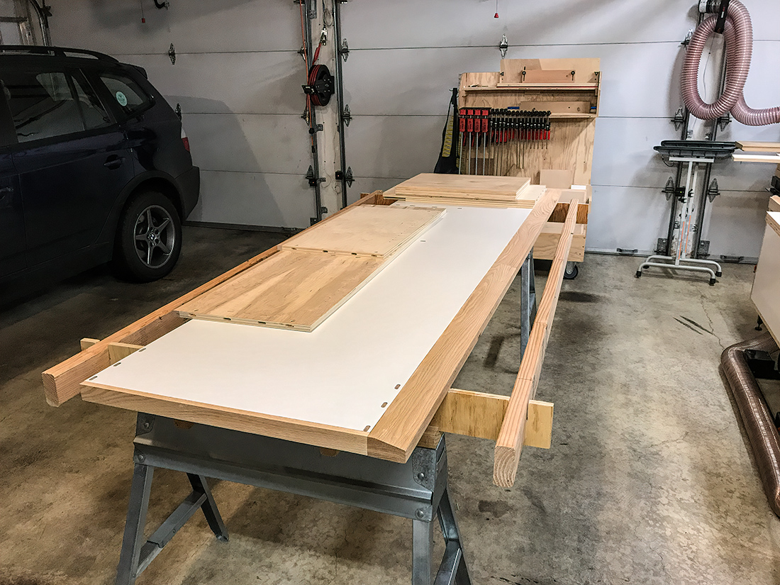

Once the desktop glueup was finished I laminated the surface with Formica as a work surface. I then added a beveled front edge to the desktop made out of oak. I had encountered a beveled edge like this once on an early graphics display workstation from the mid 1970's that I always thought was a nice edge for a computing desk. I added a strip of oak at both ends for cosmetics. In this image the mortises have already been cut in the desktop surface where the upper pieces attach.

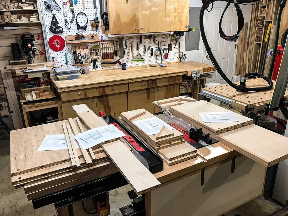

Once the primary mill work was done I sanded everything to get rid of the pencil lines I used for the layout work and clean up the surfaces. As I worked on all of the pieces I kept the panels for each separate module in piles with a printout of each module showing the numbered parts.

Nice design I like the tapered front on the desktop... I also use a combination of base coat shellac to seal my wood before spraying Minwax Polycrylic... It sprays very nicely straight out of the can in my Automotive HVLP gun. Shellac keeps the water based finish from raising the grain. You do very nice work and keep your workspace well organized. Nice!
Thanks - as I mentioned in the thread I didn't come up with the beveled edge design. Someone back in the early to mid 70's came up with it for an early graphic workstation called an Imlac PDS-1. When I first started working with computers at the University of Utah in the late 70's we had one of these that was still functioning connected to our DEC-20/60. When it died the university property management folks didn't know what to do with it so they lets us part it out for keepsakes. I scored the tabletop with the beveled edge and one of the core memory cards. I still have the tabletop although it's too small for any of my work areas but I always loved the beveled lip so I replicated it for this desktop. I am delighted to have it back - very easy on the wrists. It does take up space but I have plenty of that in my office but I never understood why no one else came up with this for ergonomics at a computer workspace.
