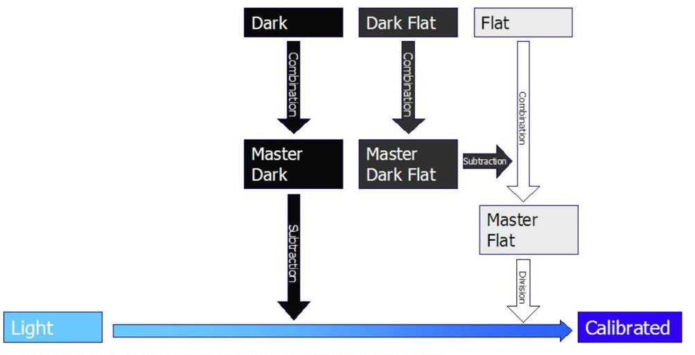

BTW - Bias frames are basically useless with today's CMOS sensors. You should be using Darks, Flats, and Dark Flats instead.
Hey Bill, thanks so much for this chart. And of course thanks so much for all of the help you have given me. You are one of the unsung hero's that has helped me a lot. But I also don't want to leave anyone out, as also @Mike Lewis @CRTAstro and @Andy Nowlen have all been so helpful. It's great that here at FocalWorld we have so many really knowledgeable astrophotographers who are so willing to help.
I have just figured out how to make some Flat/Darks. I made some the other night out at Joshua Tree. I didn't use them in the processing yet, but I did make some. So perhaps for IC 1396 which I had also shot, I might integrate with using the Flat/Darks also and try that for the first time. Thanks!
